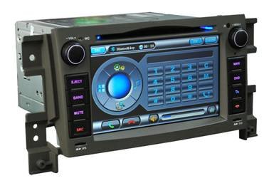

Model NO.: HP-SV700
Product Description Double din all-in-one car DVD player perfectly match Suzuki Grand Vitara
* 6.95"TFT-LCD Touch-Screen control
* 3D graphic interface
* Built-in Bluetooth function
* USB. TF Card solt on panel
* Built-in GPS Function (WINCE5.0)
* Dual Zone function (Music or Radio while in GPS Navigation mode)
* Compatible with DVD/VCD/CD/MP4(AVI, ASF)/MP3/CD-R/CD-RW
* Built-in AM/FM, 30-channel memories
* Built-in TV tuner (PAL/NTSC/SECAMTV)
* Steering wheel control
* Ipod supported
* Volume/bass/treble/bal/fad trumpet electronic
* ESP and anti-shock mechanism
* 4 Channel audio output
* 2 Channel A/V Output
* 1 Channel A/V Input
* Rear view camera input
* Support backsight when car backing function
* Full-function remote control
* 4*45W Amplifier
Accessories: Remote Control, Power Cable, USB connector, Tools, User Manual, Gps antenna, Ipod connector
